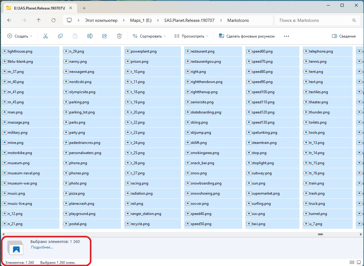

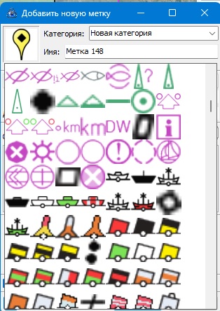

Is it possible to add to the set of placemark icons or swap them for another set?
There are no icons in the current set to satisfy the theme I am currently working on.
yes of course a screenshot 1,2

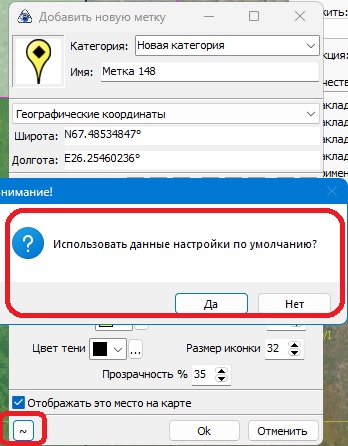

it sure would be useful if we could change their order in the display so that when I am using the same icon over and over I can move it from the bottom of the display to the top where I can get it quickly.
Is that possible at all?
yes of course a screenshot 3

So to change icons I just put new ones in the file folder. That's easy enough. Thanks.
And to change the order I just select the one I want to us for now and make it the default?
got it. Thanks. :)
