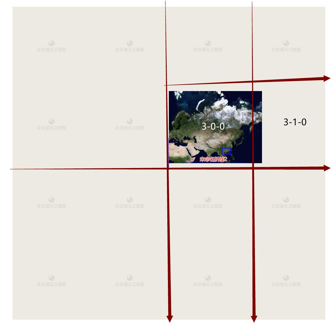

If possible, can i ask you again。
This may be difficult.
How to edit GETURLSCIPT if all the tiles are sorted out of order?
The algorithm is probably. Take the 0 degree central meridian. North of the equator. XY starts sorting with 0 and 0. Administrative new algorithm. Is it compatible with the current TMS algorithm?
This link is. Https://ss1.bdstatic.com/8bo_dTSlR1gBo1 ... ebearth2&v from China's Baidu Map =009
