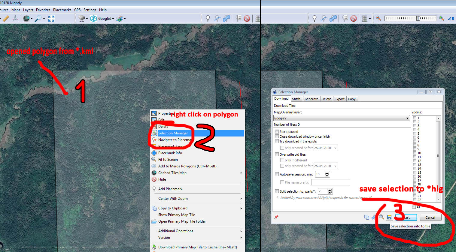

Сообщение unpointeul » 26 апр 2020, 19:14
Hi all
looks like i could not say directly my question and some people think i mean another thing ,
so this is my question :
you can see on this video
https://streamable.com/gkdjit
thanks all
unpointeul
Сообщения: 8
Зарегистрирован: 19 апр 2020, 03:09
Re: kml for seelection area (by video)
Сообщение unpointeul » 27 апр 2020, 16:38
unpointeul писал(а):Hi all
thanks all
many thanks of (Kandey 73) a user in telegram
he / she / gave an awesome option
convert line to polygon in arc gis
then convert them to kml or kmz
then import them in sasplanet
right click on area
select select manager
that's all
bingoooooooooooooooooooooooooooo
haha thanks again
Kandey 73 you're one of my best friend now . :thumbup: :thumbup:
unpointeul

Сообщение QuickBird » 27 апр 2020, 19:43
I don't know what kind of .kml you do have, they do many things
to make a highlighting file is easy, open a new text document and write [HIGHLIGHTING] followed by the zoom of your like, right below you start the selection point list
[HIGHLIGHTING]
zoom=9
PointLon_0=
PointLat_0=
PointLon_1=
PointLat_1=
PointLon_2=
PointLat_2=
PointLon_3=
PointLat_3=
following open your kml and pick the coordinates of 4 distant points (as minimum) and paste according to Longitude or Latitutde, then you can save as .hlg and DRAG AND DROP on SASplanet
the coordinates representation must be plain degrees, example:
PointLon_0=3.33778185821137
PointLat_0=51.5193605918165
You can also edit the file on Notepad+ and automatically replace all the file and the <coordinates> tag into a HIGHLIGHTING using the Replace plugin
