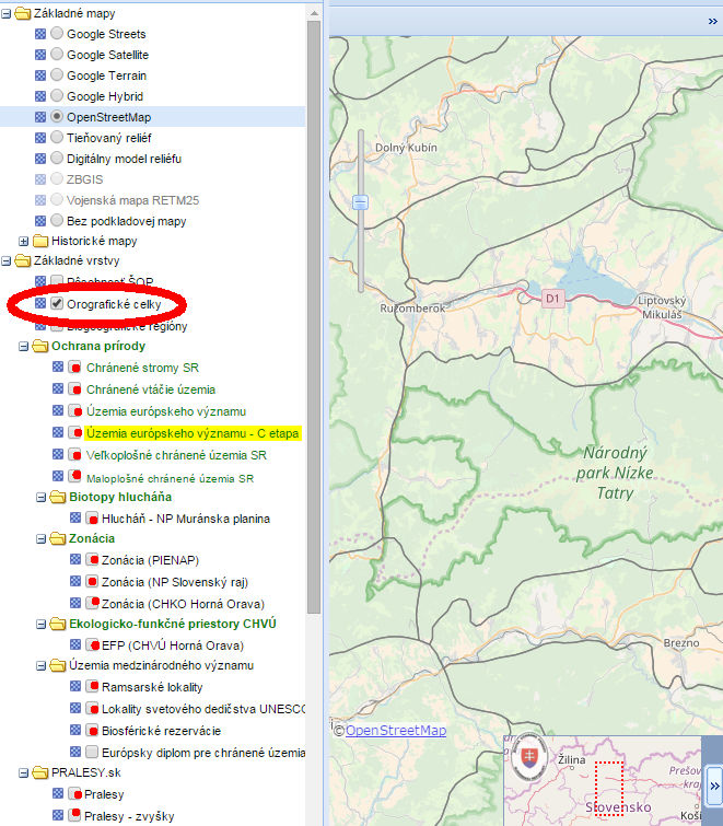

I found an alternative for MAP 2
http://maps.sopsr.sk/
on the picture, which layer I need "orograficke celky"
address tiles is above my power
http://maps.sopsr.sk/geoserver/ows?LAYERS=orograficke_celky&FORMAT=image%2Fpng&TRANSPARENT=TRUE&SERVICE=WMS&VERSION=1.1.1&REQUEST=GetMap&STYLES=&SRS=EPSG%3A900913&BBOX=2162250.9958301,6310641.3943457,2172034.9354492,6320425.3339648&WIDTH=256&HEIGHT=256
if there is no problem, I would also ask the other layers marked with a red dot
thanks
