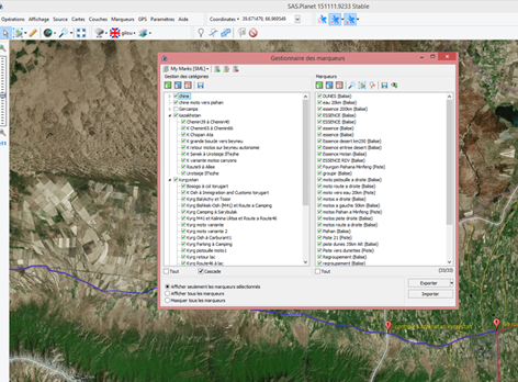

hello
I am using SASplanet 151111 and I would like to backup my placemaks manager.
could you tell me which is the name of the file to save
thanks a lot
gilles

SML marks stored in 2 files:
Categorymarks.sml
marks.sml
I recommend you switch to SQLite3 marks: select "My Marks [SQLite3]" in Placemark Manager and import your SML marks (Import -> select "marks.sml"). After this, your marks will be stored in Marks.db3 file.
