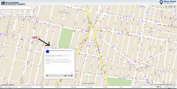

Сообщение Maximuz » 23 мар 2016, 09:10
To enable the layer you must do what is in the picture one and two, also take a few screens of the other layer functions.
Once this enabled seeks cdenue14 layer with the firebug extension of mozilla.
But only as far as I can go.
Screen 01
Screen 02
Album Screen https://plus.google.com/photos/101858508986398123823/album/6265108358572740721/6265108359743928482?authkey=CKT9rq_n4M7l3QE

Сообщение Ivan30 » 23 мар 2016, 22:20
when you use browser, server send one megatile
SaSPlanet use 256*256, so only this
cdenue14.zmp.zip

Сообщение Ivan30 » 23 мар 2016, 23:09
of course, sasplanet can cut one megatile into some normal-size ones, but I cant do it better

Сообщение Maximuz » 24 мар 2016, 05:40
Ivan30 писал(а):of course, sasplanet can cut one megatile into some normal-size ones, but I cant do it better
Thanks Ivan30, to you and Zed, I owe two orders carne asada tacos for both, I really appreciate your help, no problem with those little details that appear, you did your best effort and appreciate your help.
