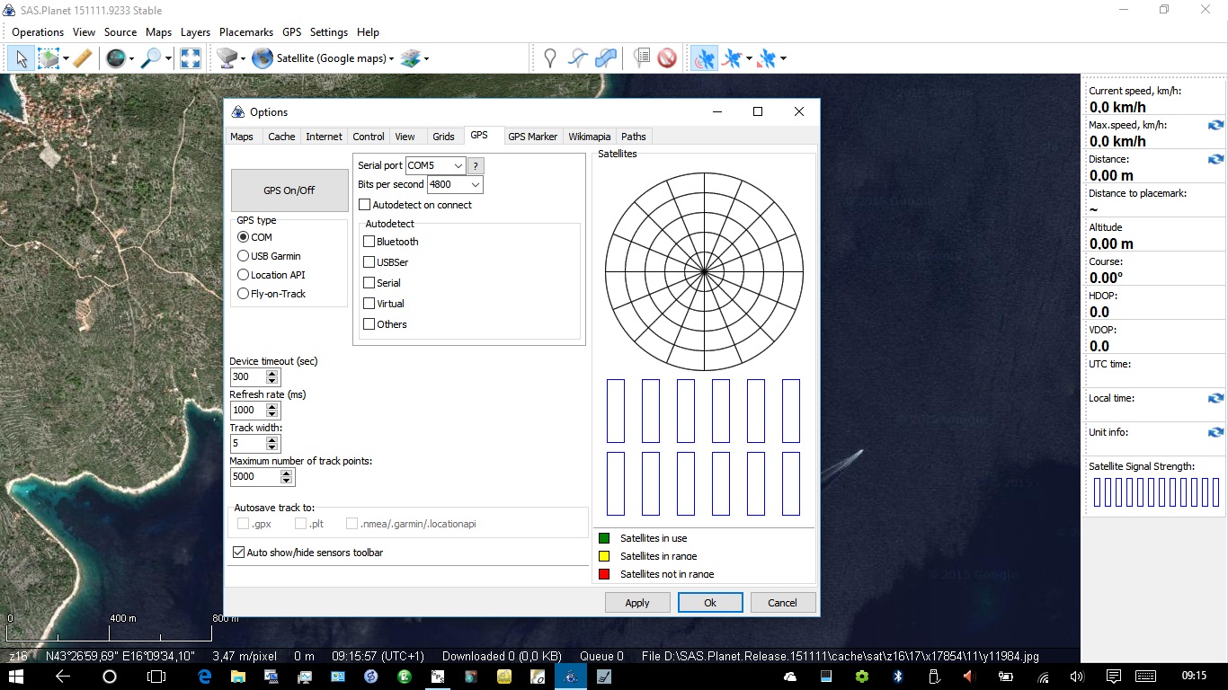

Hello,

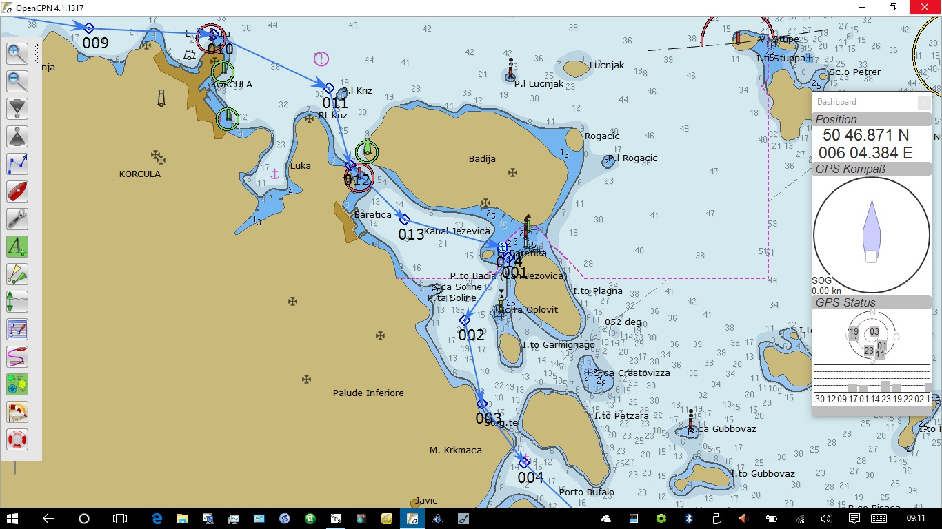

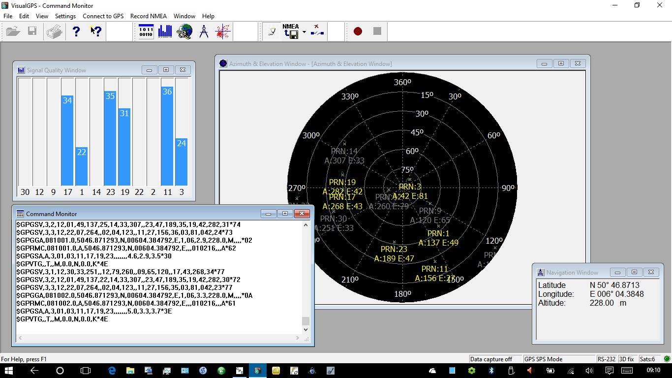

SASPlanet 151111.9233 Stable ignores my GPS. The hardware is a tablet PC (Wetab, same as ExoPc Slate, 2GB Memory) with a build in GPS running Windows 10 32bit (patchlevel is up to date). The NMEA stream is on COM5 at 4800 baud (Hardcopy1) and accessible for VisualGPS (Hardcopy2), OpenCPN (Hardcopy3) and GoogleEarth but not for SASPlanet (Hardcopy4). I already tried each option of SASPlanet but SASPlanet never showed any GPS info. Can anybody give me a hint?

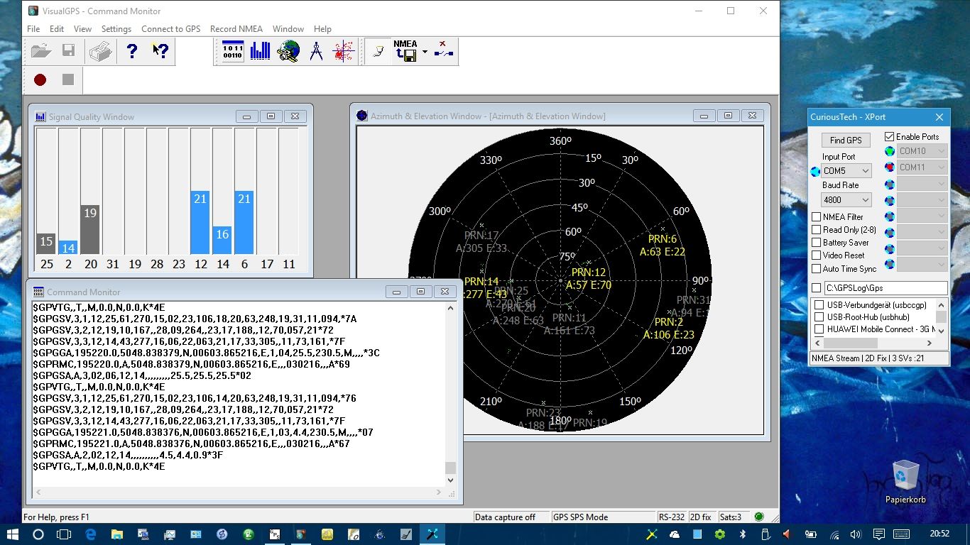

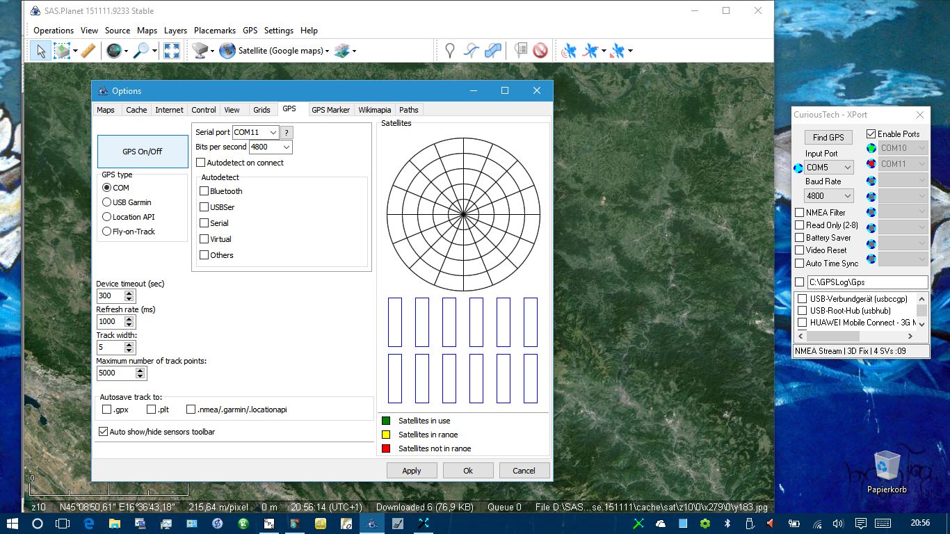

Hello,
for the next test I installed XPort (COM port splitter, like GPSGate, but free of charge). It detected the NMEA stream on COM5 (correct for my configuration) and splitted it for COM10 and COM11. Then I started VisualGPS (configured for COM10) and the stream on COM10 was OK (the red point in front of COM10 turned green in XPort, because COM10 was locked by VisualGPS). Then I started SASPlanet, but no stream was detected on COM11 by SASPlanet (SASPlanet showed no sensor toolbar and the red point in front of COM11 remained red). Are there any limitations concerning GPS in SASPlanet?
