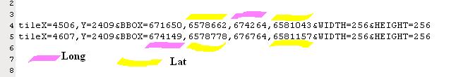

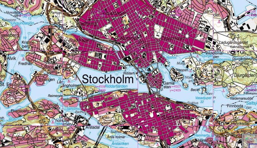

Hello,
the dll proj480 allows to use the local datums and projections.
If the accuracy of the dll is often excellent, sometimes the tiles are not close fitting.
Here is an example of Sweden in Stockholm where we see the imperfect junction tiles.
EPSG projection used 3006 utm zone 33, one might think that the passage longlat EPSG3006 would be relatively simple.
The distance measured between the points of junction can reach 50m.
Is that the variables of the dll files are double-precision?
I hope these items will allow you to examine the problem.
