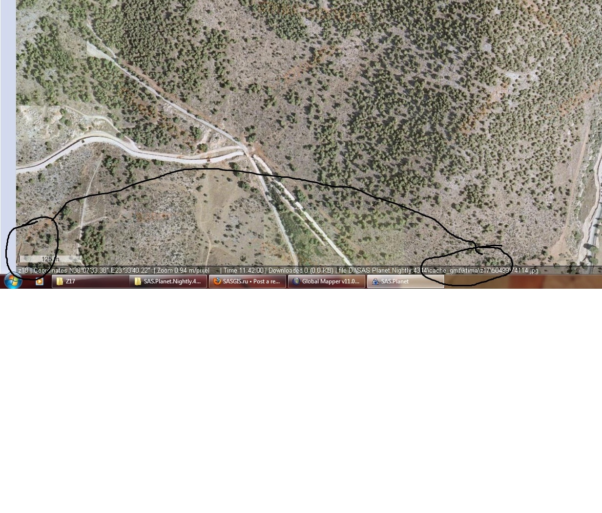

Please can someone help me with a problem ???
I use global mapper to take tiles ...
I use the zoom 17
When i use the z17 file on the sas planet i have a problem
I have on sas planet the zoom on 18 but it read the z17 file... (Look Image)
On the GetUrlScript i have this
begin
ResultURL:=GetURLBase+'';
end.
.jpg

Сообщение Tolik » 16 окт 2011, 14:10
It's easy. SASPlanet counts zooms from 1 but Google, etc. from 0.
Сообщение omek07 » 16 окт 2011, 14:12
Thanks Tolik
Do you know how i can fix it ???
omek07
Сообщения: 12
Зарегистрирован: 01 окт 2011, 22:51
Сообщение Tolik » 16 окт 2011, 14:18
omek07 писал(а):Do you know how i can fix it ???
You can't fix it. Just remember that SAS' zoom 18 corresponds to GM zoom 17.
What's wrong with it?
P.S. ResultURL does not matter because you just use cache.
P.P.S. I just recognised why SASPlanet counts from 1! Because it is written on Pascal while the rest of the world on C :)
Сообщение omek07 » 16 окт 2011, 14:30
Now i dont have problem but when i want to export the image with Stitch the export images is to big i thought.....
